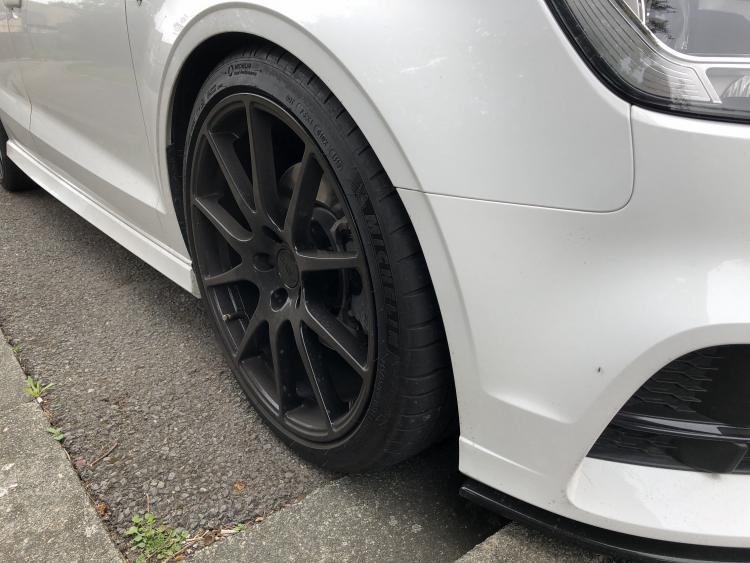

Pic below is the REVO RV019 8.5J alloy and 245/35 tyre combo I spotted on a saloon. Looks just right with the sidewall not bulged so it actually allows the tyre to work properly (ride comfort as well as grip)

I had the 245 front 235 rear and it was awful. But it seems to be the staggered that cause it so hopefully as you say 245 all round would work fineNow that I have tried the various options of different tyres brands and different sizes and profiles...…..if I had a clean sheet and started again I would probably fit 245/35/19's Michelin MPS4S all round (preferably on a set of 8.5J REVO RV019 alloys). In my opinion these would offer a decent level of ride comfort but also give good grip and least amount of hassle with the traction control.

Makes sense, the smaller front wheel width is the main difference.
The C63 runs a staggered setup with a 9" wide rear wheel as opposed to the 8.5" on the front of the RS3 which would explain the bulge you're talking about.
245/30 might be a good compromise, but doesn't look like many suppliers have em in that fitment unless you go to the likes of oponeo or tyreleader. I wonder whether MPSS might be slightly more narrow in the 255 fitment, really would depend on the makeup of the tyre.
If it's as bad as you say it almost sounds like it'd be worth going 225/35 and 245/30.
If the fronts at 8.5" look dwarfed by a 255 wide tyre I'd imagine an 8" tyre will have similar issues with a 245 width at the rear.
Or is your setup not staggered?
