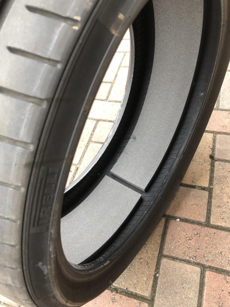

The RO2 Pirelli with the NCS foam glued in...

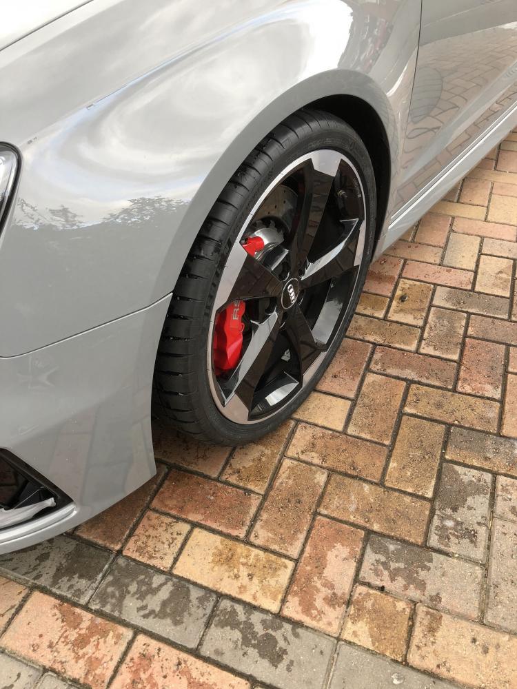

View of the 255 Michelin fitted to the front
....and a view of the rear Michelin but in 235 size.

Have you put a tape across them to check the actual width on the rims as the Pirelli could have actually been slightly under size.? 🤔
I've seen this with motorcycle tyres between makes mate.🙁

Wondering if it would have been better to have gone for the 'square' set up of having 235 width all round. Be interesting to hear if anyone is running the 235 tyre on the front.

The NCS system isn't available on the 235 size at all, only the 255 width. Also IIRC the NCS system wasn't around when the RS3 was launched.
In addition the P-zero tyre itself was updated to the PZ4 variant in late 2016 to compete with the new offerings from other brands. So again, some cars will not have had this updated version.
